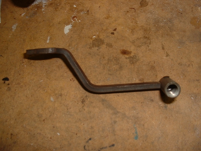

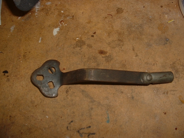

          • kenrobb
            Re: '66 FRONT SHOCK UPPER NUT REMOVAL
            Here are 2 pictures of a K-B tool I bought many years ago. #465 stamped on it. Has swivel end that is internally threaded. Other end has 3 slots to fit over end of rod.
                Thanks for the info and the pics. Under normal circumstances, the tool should not be required, is that correct?
                • Ken Robb
                  Just makes it easier to work on the shock. I can remember using the tool on my 56 Chev back when. If shock threads are a bit corroded, then tool is a life saver as I remember. NAPA has one also for a bit more $.
