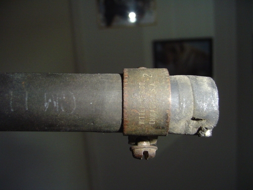

    I would have to say that the screw clamps are more correct, but this doesn't mean some barely literate line worker didn't apply corbin clamps to your "T" junction also. My expansion tank was thrown behind my seats in a pile of parts when I bought my 67 coupe. The upper, overflow line from radiator was still attached to tank. Here's a photo of original rubber line with Wittek clamp, I'd get some screw-type like you mentioned, ditch the corbin ones.
