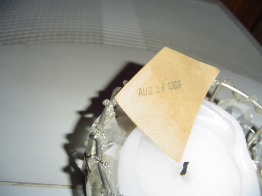

      My original door panels are from "Aug 26 1966" for my Dec 19 1966 built 67 coupe. I thought my panels were a long way from assembly production, but maybe white was a rarity for coupes?

        Inventory control in those days wasn't what it is today; not unusual.
