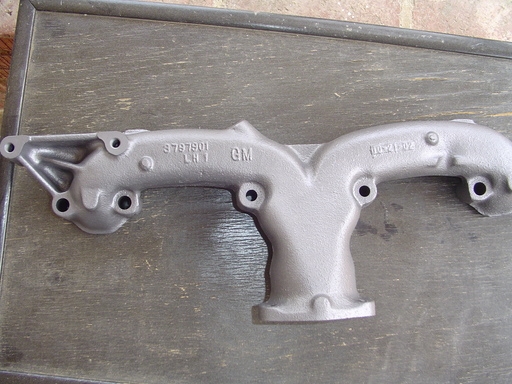

              Re: Macneish Exhaust manifold re-skin
              Here's what iron manifolds with Jerry's process look like after three years and several thousand miles; no rust, no flaking, no problems ('69 Z/28).
