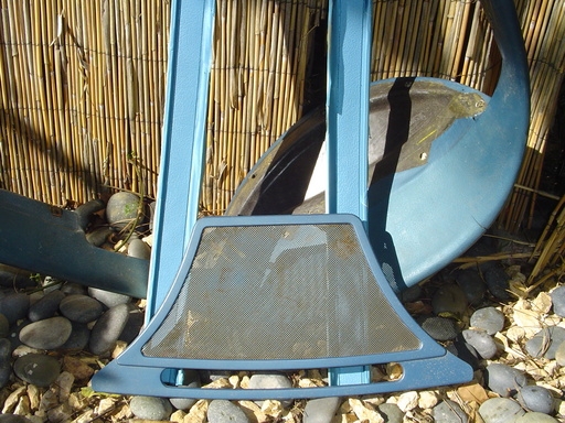

        I restored mine by stripping it first with Jasco. It still had some bright blue left in the groove you're speaking about. My piece had never been repainted or removed before I did so, period! I was having problems matching the different hues of blue between dashpads, console, and speaker grill. Although a beater, my car is very original. Good Luck!

                I can't speak for the process used on the consoles, but I bet they layed something over the top and ran in through the paint booths the same time as interiors for the car were done? The two legs of the console had the most amount of blue in the groove.
                While working for the largest Manufacturer of vintage Mustang part in America, we made a fiberglass mold of the inset of our styled-steel wheel used from 65-67. It simply sat on top of wheel face, but exposed the areas to be painted silver argent. The wheels were sprayed this way, one at a time. I bet GM did something similar many years ago.
                Justin #41362
