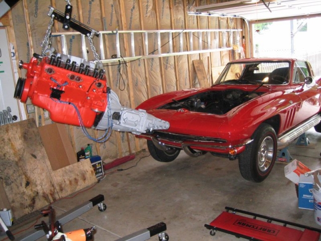

    How do you tell a 6 qt pan from a 5 qt pan? Catalog for power steering conversion says 340+ cars need to swap 6 qt pan for 5 qt pan and change dipstick. (Clearance problems I assume) My engine is not original and I don't know which pan I have. (The car is going to be a driver and the PS will allow my wife to enjoy the car also)
    Link to picture of pan in profile below.

    You are in luck. The Pan you have is the correct 5 qt. piece if you want Power Steering.
