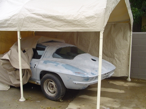

    I'm looking at basically an original, unrestored '67 coupe 327/300 Air car. Somewhere along the line, someone has added factory style side exhaust. My question is this: how difficult is it to remove the side exhaust and return the car to the original factory rear exhaust? There has to be more to it than simply cutting two holes and putting the rear bezels back in the rear panel. If I buy this car, my intention will be to have it flight judged after I've restored it.
    Am I making a mistake considering the purchase of an otherwise original '67 coupe that has side exhaust added to it?
    Thanks for any insight.
