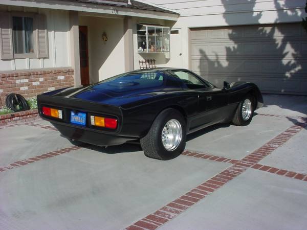

            • mike cobine
              Good shot of Transaxle
              And a non-iron big block
