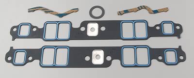

    I found a thread in the archives where Clem Z recommended .005-.007' SS shim stock for blocking the heat riser x-over (aluminum manifold only). The only source I have found so far is Fastenal, which sells a large roll which has to be ordered. Only brake shims (not SS) at auto parts stores. Any suggestions?

      The nice fel-pro gaskets come with shields but there are still holes about the size of a dime in each. I went with these and do not have any problems.
      Fel-pro part #FPP-1256 $16
