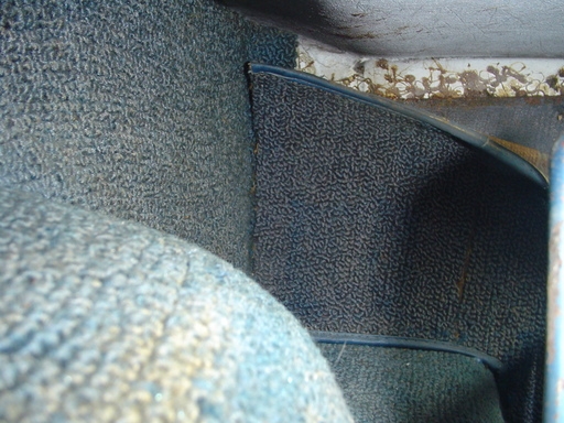

      It's my understanding 63 through late 64, the carpeting was 'edge bound'. It was later replaced by molded carpeting which is correct for your car. I have numerous shots of my original 67 carpeting in you need. I have the #450 Blue/white interior. Here's one looking over the passenger, rear wheelwell to back.
      Justin #41362
