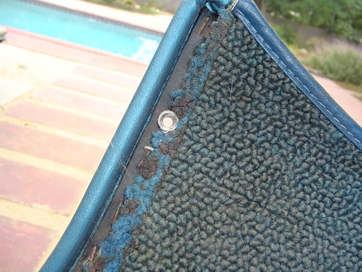

    Dave,
    Here's a shot of my original 67 bright blue kick panel. I think this is the rivet you are speaking about. Maybe something like a "C" clamp to have enough clearance and squish rivet flush against fiberboard and carpeting?

      Re: C2 Kick Panels
      Dave,
      My 66 kick panels may not be original but the reinforcing rivet is only in the backboard and not the carpet. Curious to see what others report.

        Makes sense....
        ...because this is where the metal pinch cap goes over kick panel. You can also see how my rivet is off to the side of the carpeting more on the fiberboard. Mine are the originals, so this is a factory application.

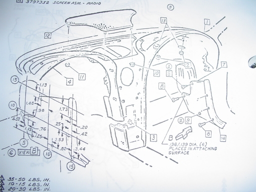

            67 Assembly manual....
            ....is the best I can do until I go out there this weekend for photos.

              Re: 67 Assembly manual....
              I don't believe Al's replacements are intended to be crimped, just to look sort of correct from the outside.
                I believe that is not a rivet but a countersunk washer that is peened over. I would use a counter sink washer not a rivet. You will get the same effect as the original except it is not fastened to the kick panel. Any auto store or even Home depot or Lowes should carry them
