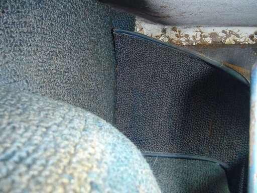

    Here's a shot of my 67 inner rear, passenger side carpet. I am missing the piece of material that is glued up below window, but all else is as it left the factory! It seems the sides were done first and the back piece next that has the plastic border. I haven't touched anything, so this is how it looks from the assembly line, of course well-aged.
    Justin #41362

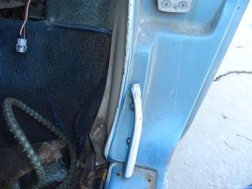

        Thanks for the quick reply! Here's a photo of the area I am trying to figure out. Appreciate the help!
        Dave Z
        Dave Zuberer

          --------The first picture is correct. As well, there is a very small screw that secures the carpet to the panel only, not thru the panel. Get the screw from Long Islands catalog so as not to use the wrong one. Im pretty sure the screw goes thru the carpet about an inch in from both the top and the rear edge. Hope this helps!..........Bill S

              This is all I have intil I go out to the car. I'm trying to get out there, but things have been hectic around here(taxes, Fire academy,5 month old)! I can explain the original hardware for the quarter trim, but I haven't seen the screws for carpeting at that particular spot. Here's a clear shot of the factory paint for two-tone interior and a pinch weld cap. I'll shoot some more pix soon!
              Justin
              • Bill Stephenson
                Re: 67 Coupe
                Justin,
                ------If you look closely you can see the screw I mentioned in your picture!!!!!..........Bill S
                • Bill Stephenson
                  Re: 67 Coupe
                  --------I should have mentioned that the old carpet has apparently been pulled away in this picture. This is common as a lot of people dont see the screw there when pulling on the carpet. The carpet, being old, pulls away leaving the screw still in the panel. Hope this helps!........Bill S

                          Here is another photo of an original carpet installation. Note the chrome phillips pan head screw with integral v shaped washer is barely visible.
