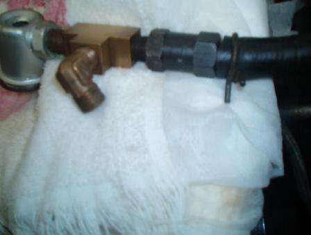

                  The PCV valve has the # 5645907 stamped in it. It also has a cirled AC with dash on each side and arrows on each side with 'to manifold' stamped in it too. I have taken digital photos. I hope to get someone to show me how to post them soon. On the back of the front carb is a brass block to accept the black AC hose.The AIM as I recall(it's down at my shed)only shows a sigle carb with the PVC valve screwed into the L shaped brass fitting on the carb end of the black hose.The brass T block with the PVC valve on my car would not fit between the two carbs.I'm suggesting that any dual carb car with RPO242 the factory must have mounted the PVC valve on the brass T in the back of the engine with the adapter out of the block. I'll try to get the photos up in the next 8-10 hrs.
                  I can't help with the oil filler cap because amongst the stupid things I've done in my life is losing- (probably thought it would not clean up any longer and thru it out) my original cap. I do clearly remember it was a breathing cap. It had holes around the bottom of it and one could see the metal strands inside the oil cap body. I cleaned it periodically with cleaning solvent but I can not recall the markings. I am certain it was black with a cleaning instruction lable on it. Photos soon

                            Re: PCV numbers
                            The fitting pointing down had a hose on it. The numbers match for the valve shown in AIM for rpo 579-582. There is no number on the valve in RPO 468-469 drawing. Most likely used the same PVC valve. So back to the original question, RPO 242 had to have a breathing cap to work correctly didn't it? Air would flow down the oil filler tube to crank case and the crank case air is sucked thru the PVC valve thru the black hose to carb and then combusted. If that is correct what do you make of the fitting pointing down that had a hose on it. It seems to me that would greatly reduce the suction on the crankcase. Maybe it was just to add some clean air to the crankcase air so that it combusts better.

                              Richard -
                              The photos don't show up here (just the "red x" box), but I did the right-click > properties > cut-and-paste trick, and they showed up, but there awfully tiny - couldn't make out any detail. I usually shoot at 640x480 and it makes an image just right for posting (doesn't require scrolling).
