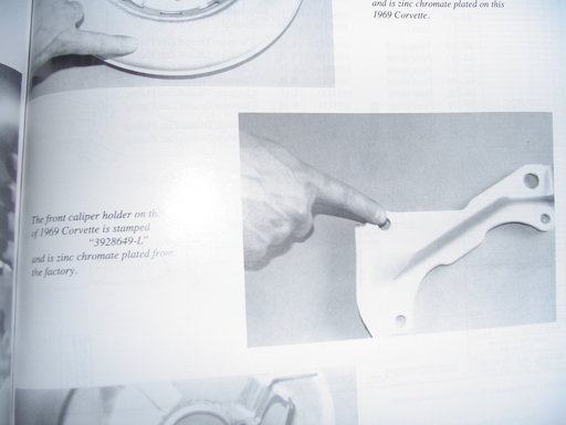

    The Chassis Resto book says the were Zinc Chromate plated from the factory. I took a box of parts to plater and asked for silver cad. I'm not sure which plating she applied, but they look great! I used Van Nuys Plating, on Bessemer St. in Van Nuys, CA. It's near L.A. in the valley area if you are in Cali.

      If they are silver, they are probably zinc...especially in California. The two finishes were used interchangeablely, and some knowledgeable restorers have sworn that zinc and cadmium are indistinguishable. Much more difference is made by the surface prep before plating, i.e. beadblasting vs. acid stripping, than by the plating process.
      Without being told the topic of conversation is plating, zinc chromate is typically understood to be that green zinc primer used on Corvette bird cage, aluminum parts, and aircraft. A plater might use the term "zinc chromate" as one ultra-familiar with the process, but he actually means zinc dichromate...a clear zinc plated part given a dichromate "wash" or dip that gives it the gold color with rainbow hues.
