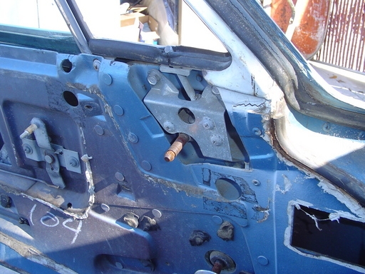

      Keith,
      It should also be present behind your door panels as It is on my 67 coupe, job # 104.
