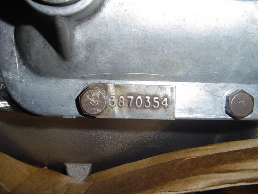

          Another indicator is the tranny side case cover tag if still present. It is held by one of the case cover bolts. 3870354 tells me I have a 3:36 posi with (wide-ratio) Muncie for my 67 coupe. Thunder woke me out of bed!
