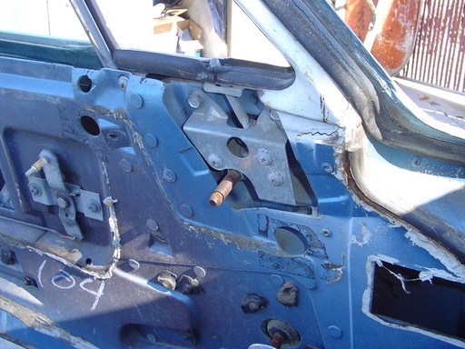

            Larry,
            I don't know enough about the C1's to help with the grill, but the job number on my 67 coupe is the same as your 66 bigblock I think, #104. Good Luck!
            Justin #41362
