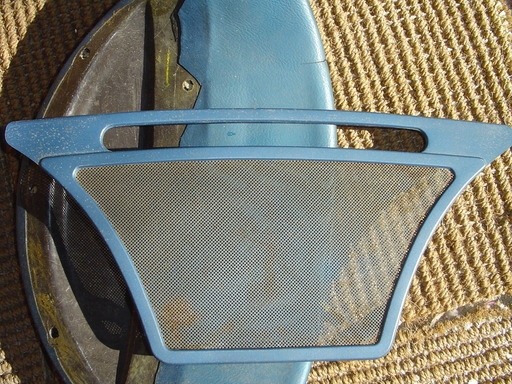

    Members,
    I Just finished my center console with paint from Paragon. It's way too greenish aqua. I set next to it an original dashpad and speaker grill with factory blue that is a bit darker and no greenish tint. Which paint supplier has the correct color? Thanks!
    Justin #41362

        Re: C2- #450 Bright blue/white-67
        Wayne,
        I shot another photo hoping it would be better than the first. I need the bright blue, but the stuff I used from Paragon is straight aqua. To me it's not even close. The original blue is darker and has a slight metallic 'flicker' when you look closely enough to the dashpads.
        Justin

                            Re: C2- Who's got good blue?
                            Justin - According to your profile, your '67 is very much like mine. From the posted picture, it looks like the radio speaker bezel is closer to the correct color blue. It should be a MEDIUM BLUE, not the silvery blue. Your white/blue interior should have a medium blue finish on dash pads and console. At one time, ACC was the only vendor with the correct color carpet. Latest discussions at the Winter Regional Meet indicate their patterning (carpet fit) is not as it used to be. Everyone else had bright blue, which is incorrect for our Corvette interiors. BTW - I removed the factory carpet, etc. and replaced with repro. Still have the original carpet in sad shape but the color is medium blue.
                            Good luck with your restoration,
                            Kent #6201
