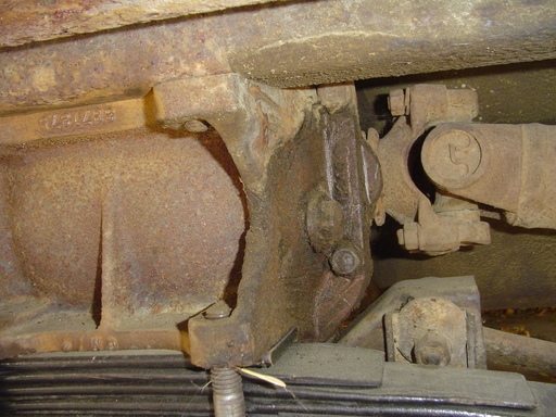

    I'm pretty close to where you are with concern to restoration. I have a 67 coupe and have the last attachment holding the body down. I removed mounts up front on core support, one on either side of firewall, one on either side behind plate in rear wheel wells, and one on either side at rear. I now only have the seat cable undercar to frame holding things down, I think? It's not difficult to remove mounts, just how to lift body carefully, safely, and have a dolly ready. I purchased the Noland Adams body lift manual with video from NCRS. It has drawings to help with the dolly build. Here's a shot of the rear-undercarriage of my previous East coast, salted-road, and now West coast muddy field coupe.

          Justin and Rod thanks for the comments on body removal. Justin, mine looks kind of like your's from the photo.
