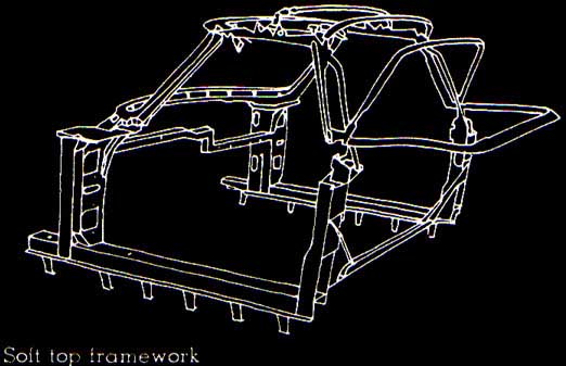

    My definition would be the metal substructue of the main body shell. There is a good picture in the Noland Adams book.
    • Brian Monticello
      Re: BIRDCAGE Definition
      Here's a line drawing from the '65 sales brochure
      coupe
      convertible (the convertible frame is not considered part of the birdcage)
