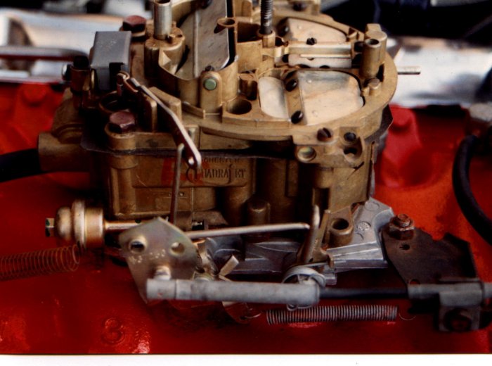

    Are there any experts out there on the Carb Idle Control Solenoid or sometimes called a deceleration valve? My understanding it was put on cars with 4 speed and air in 1970. It mounts on the carburetor where the typical idle set screw is on the Quadrajet. Was suppose to keep the engine from decelerating to fast if you let off the gas to quickly. Maybe the extra drag from the A/C could cause the engine to quick?
    I hardly ever see this on cars at shows. Is it peculiar to 1970 production year or maybe only part of the production year? Does anyone know the time period? Was it used on other cars besides the Corvette?
    Is anyone reproducing this valve? Any guess on what a used one or NOS valve would sell for?
    Thanks for any info / Greg

        Thanks for your replies. The Carburetor Idle Control Solenoid or deceleration valve as some call it is separate from the TCS system. TCS was on all 1970 cars, both auto and 4 speed trans regardless of A/C. The idle solenoid was only placed on 4 speed cars equipped with A/C. It appears very little is known about it, there is some discussion on it in the archives. There is a picture of one on a 1970 LS5 car on the 1970 Corvette Registry site. I've put it in below. The valve replaces the idle set screw on the carb and has a set screw on one end and a small plunger on the end that rests on the throttle plate shaft. There are no vacuun or electrical connections to it, it is strickly mechcanical. I think the part number for it was 1114421.
        I'm trying to see if anyone knows when it was discontinued and just how many cars it was used on. My guess it was on all cars that were equipped with 4 speed and air, but I don't think it made it very far into the production year. I have seen one Chevelle equipped with it. I don't think it is reproduced, and am wondering how much a used or NOS valve would cost.
        R / Greg
