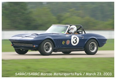

                    • Mike Cobine
                      Re: C2 small block intake flow rates
                      They've tightened up. I knew a lot of SVRA guys that ran Victor Jr manifolds and even a few that had aluminum heads. Some of them painted the intake and heads orange to look "original".
                      Did SVRA have them remove the fender flares or are they still running those? What is SVRA running as the cut-off year now? The flare never became legal until '72 and only if they copied the original profile when viewed from the side. That means round flares like these were not legal in SCCA in '72.
