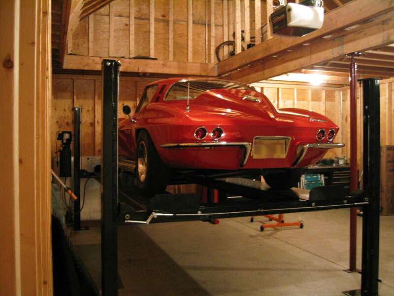

                              • 11640
                              Re: Need a Lift--Comments Appreciated
                              Would have been disappointed if you hadn't shown up with a pic...
                              As John well knows, I have 2 of the Cytech lifts. I love them and wouldn't trade them for anything. Another NCRS member locally also purchased one and has zero problems.
                              I love the casters, but also find that the powdercoating and finishing seems much better than other brands I've inspected.
