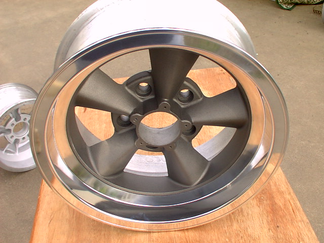

          Don, I wanted the period look for my Top Flight convertible so I got 6" Torq-Thrusts custom made by PS Engineering in Torrance, California. They have zero offset and like the original American Racing Torq Thrust D's, they clear the calipers. I went with polished outer rims and natural spokes. They were mounted with 215-65-15 Eagle GA's with no clearance problems. Good luck. Jim Weeks, Member #2978

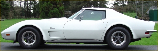

              Re: Wheels and tires
              Thanks Duke. I appreciate the advice given last winter. The wheels and tires have performed flawlessly this summer!
                Oops. The pic did not work. Here it is.
