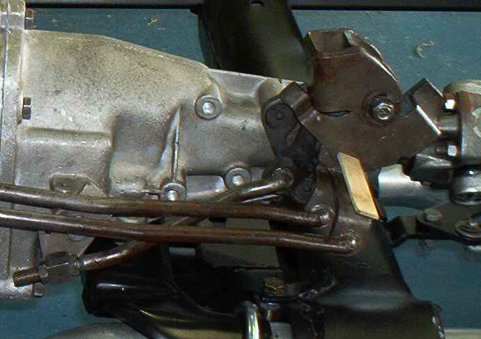

                  When extended, the rod on the reverse tee hits a knob that prevents the shifter from moving into position to move the reverse linkage. If the rod is removed it should go into reverse. The knob is the end of a threaded shaft that is welded to the shifter. The knob could move but it is not likely and would possibly affect you ability to shift into 1st or 2nd.
                  I suggest getting under the car and checking the condition of the linkage. It is tight fit. The picture below shows what the linkage looks like. The trimmed paint stick seen in the picture is being used to adjust the linkage.
                  Dave
