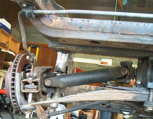

            It this the offset you are taking about? This bar was on my 65 327 when I bought it. I am curious what it is.

              Yes, this is the GM #3967713 rear bar originally used for 1969-74 Corvettes with big block. As you can easily see, it will fit any C2 with no problems, at all. However, it was never originally used on a C2, and, certainly, it was never originally used on any C2 small block.

                Dave, great picture - I sure know what it looks like now.

                  If you want the one in the picture make me an offer. I do not plan to put it back on my 65 small block. It has been bead blasted and painted with the stainless steel paint sold by LIC. It includes a new set bushings and brackets for installation (except the bracket that mounts to the frame, I think).
