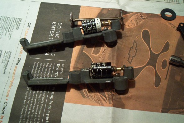

      • Dave McDufford
        Re: Trip odometer reset - 1965
        This is what the unit inside the Speedo looks like. When you push on the cable the gear you see in the top unit pushes up and disengages the speedometer gear and you can rotate the cylinders (if that makes sense). The parts you see here is from Corvette Specialties of Maryland and are not cheap, but are not outrageous.
        Good luck.
        Dave
        • Donald T.
          • September 30, 2002
          • 1319
          Thanks for the help! The picture was very helpful. I'll check with Corvette Specialties on the parts. It's gotta be cheaper than sending the whole dash in for a rebuild!
