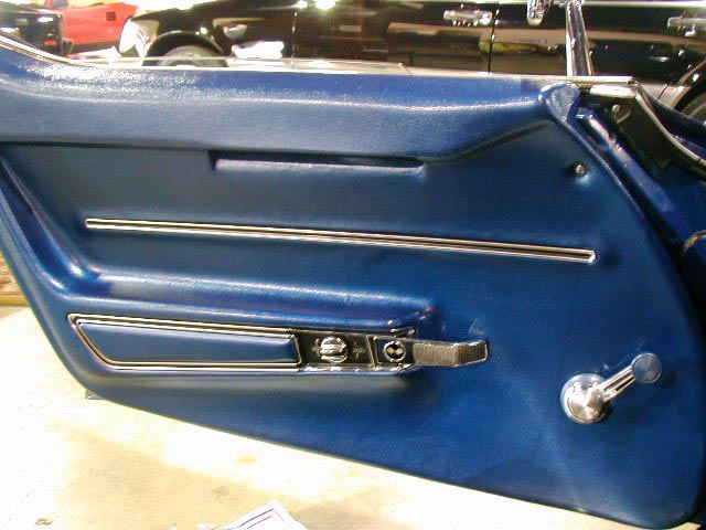

    My 68 interior is 411 but not terrible original - besides I have power windows.
    I can't vouch for this car but it is advertised as a super original low mileage survivor. Knob appears to be blue.

          Thanks, a picture is worth a thousand words. Terry

            Yes, Mark, that is the shade called "dark blue." The other one is a bright blue. A picture is much better than word descriptions.
