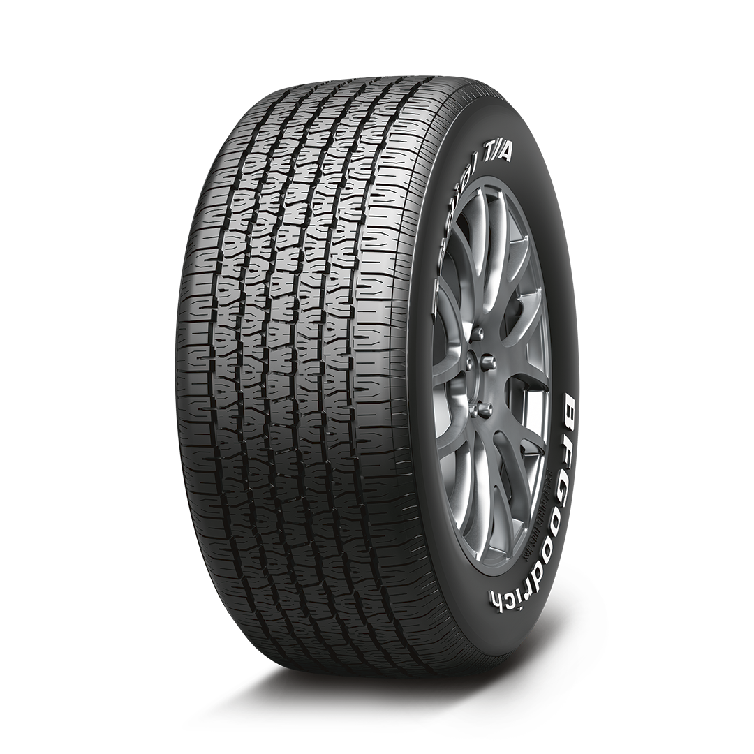

            Work your way down through to the Sizes and Specs and you can frequently find a PDF file that has the charts like these:
            http://www.bfgoodrichtires.com/assets/pdf/radial_ta.pdf
            http://www.bfgoodrichtires.com/asset...ForceSport.pdf
            Then you can find recommended rim widths. Usually the range is a bit wide, so the center is the ideal spot. The Radial TA P215/70-15 lists 5.5 - 7.0 for rim width.

                    by far is to get the tire manufacturer's charts, like this on on the BFG T/A:
                    http://www.bfgoodrichtires.com/asset...raction_ta.pdf
                    Comparing those to the calculators (most are wrong because like you said, they don't understand tires in dynamic motion) like this Miata one shows that the Rev/mi is definitely wrong.
