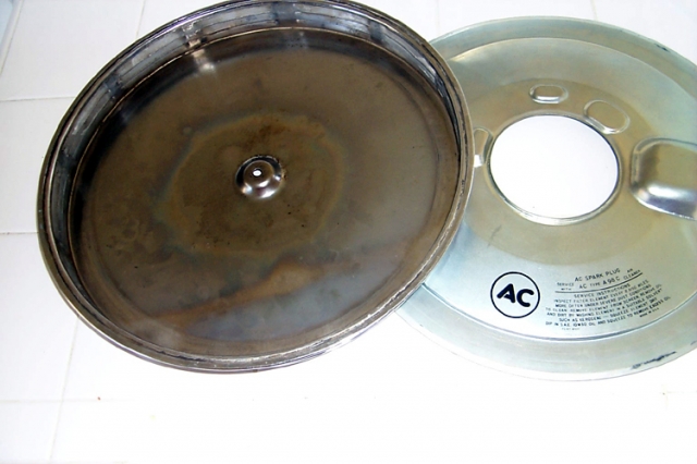

    Rob, the air cleaner top you have is not the original one nor one of the replacements from somebody like Corvette Central or Paragon. I just got one and it is aluminum and has a cloth/fabric flame arrestor sandwiched between the top and a stamped blade part. Bottom looks exactly like the one I just bought from Corvette Products which is incorrect because it does not have extensions going into the carb top. Please see attached photos of my old parts and the replacements I bought.
    I also show a picture showing the gap we discussed between the top and bottom. I see this same gap, caused by the carb stud spacer and/or the paper filter on my original parts, my new parts and photos of other engines I have. Cannot assure this is exactly correct but I am leaning toward it since you have a non original top.
    I plan on picking up the foam and wire air cleaner soon.
