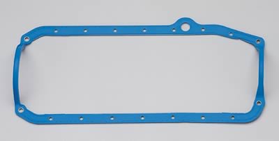

            Depending on your goals, I do not think you would need any additional gaskets whatsoever. The only exception (and this is likely what Joe is thinking too) is if you preferred a one-piece oil pan gasket to the stock 4 piece type (see picture below). In that case get FPP-1885 at $37.88 in addition to the above kit. As it is blue, be prepared to install it before you paint the motor. I have this gasket on my 71, but have other cars with the standard 4-piece oil pan gaskets including my recently finished 66 327 motor.
