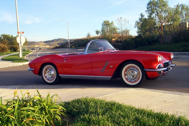

            White Walls are too wide... *NM*
            • Rob Edwards
              Re: White Walls are too wide...
              I know, I know, 8-) Should be 7/8", right? We'll see how fast we can wear 'em down so proper replacements may be fitted. Those tires are Cokers and the treadwear rating is 500 (!?!??!)

                  And wheels should be black, not red. (Picky, picky, I know--looks like a nice car--but Dennis started it!!!)
                  • Rob Edwards
                    And that paint, it's not (gasp!) lacquer! (m)...
                    Perhaps I can just keep posting pictures and we can have a virtual judging event. (That'd be kind of cool, like "How many things in this picture are incorrect?") Part of the fun of learning about this car is discovering all the things wrong with it, especially since it's my wife's boss's, and anything it needs to make it correct again comes out of his pocket. I'm just the historian and maintenance guy. In the meantime, it is an awful lot of fun to cruise Newport Beach in! Thanks again for all the input!

                      Rob, such a beautiful picture of a beautiful car that I had to use it as my desktop background picture, temporarily replacing my red on red 66. Hope that this is ok.
                      regards, Steve
