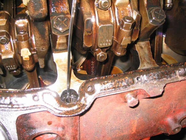

    A cam, intake, and carb change has blossomed into something much larger and I'm trying to decide if I could tear the engine apart. I snapped some pics this evening.
    Can anyone identify piston 3795709? - they all have the GM casting. The engine is NOM and is a '67 327 casting 3892657 code HC.
    Also, It looks like all the bearing caps are marked 1-8 with dots. Can I assume that the factory did not do this and that someone has been inside?
    I'm perplexed as all the gears and the oil pump (and pistons) are GM - it even has the nylon faced cam gear. I doubt that anyone would rebuild an engine and replace everything with GM components. Maybe someone did a simple re-ring and left the rest alone?
    Brian

    HC is a 327 1966 to 68 275 HP 4 barrel, PG,passenger car. the punch marks are not from the factory. is the bore std 4.000? years ago GM sold parts for rebuilding engines and if you had a connection with a dealer for a discount you could not beat the prices.

      I agree with Clem-----the punch marks are not factory-applied. Given their presence and the fact that this engine looks like it still has the original factory paint (i.e. you can see the "HC" code through it), I'd say that this engine has, at some time, received an in-car "bottom end rebuild" or a "ring and valve job" with the block staying in the car.
