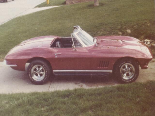

    My '67 327 roadster has always had a bit of a problem being aligned properly (front end) and I am wondering how typical that is and what if anything I can do about it. The problem is on the right upper A-arm rear bolt location where it has just about as many shims as will fit the standard bolt length, and the front bolt has only two. The left a-arm has just 1 or two shims at each bolt. I have heard of the opposite problem, where all shims are removed yet the a-arm still needs to move outward. My frame is rust free, and if it has been damaged it isn't noticeable. Should I get longer bolts? Have others experienced this problem?
