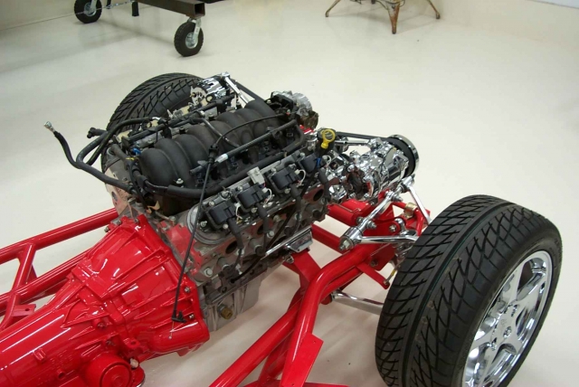

                  I used Sherwin Williams Armorshield 1000 HS floor epoxy. It is a solvent-based industrial epoxy floor coating that wears like iron. We use at work on all our shop floors and I have been very pleased with it for years. I spent about $500 doing a 900 sq/ft shop with me doing all the labor. It is money well spent! The included pic is not great, but it is the only photo that I have up on the site now that shows the floor. It is way glossier than the pic makes it look and it is an extremely light color. They will mix any custom color you like.

                        Enough about flooring
                        What engine is that and what car?
                        Gary

                              Re: Enough about flooring
                              Gary,
                              That is a completely numbers matching 59 corvette! LOL
                              Actually it is a SRIII chassis with C4 fromt and rear suspension with a LS1 engine and 4L60e trans that will have a 59 body. I will send you some pics of it when I get home tonight.
