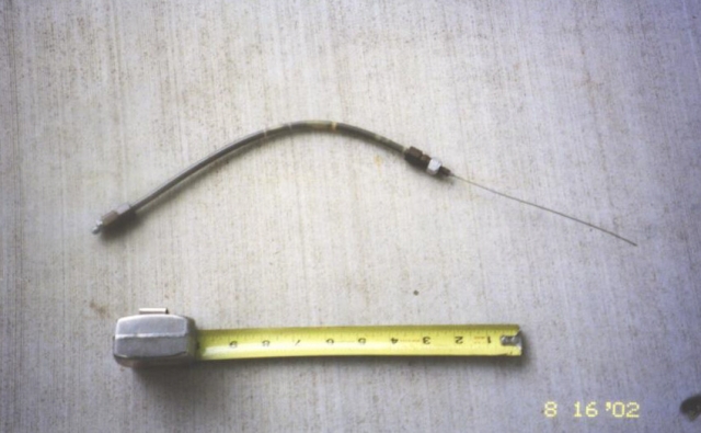

            I always greased them in place, annually, with a hypodemic needle set-up. See link.
            Geezer
            Rear wheel bearing grease
