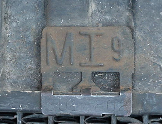

                              3018802 is MI9
                              I've been trying to post a picture of the tag. Lets see if this one works. Thanks to everyone for helping and Happy Holidays!
