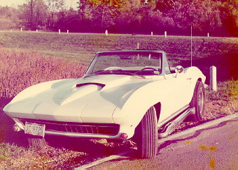

    i have a 66 327/300hp roadster, 4 speed, no power brakes no power steering, its getting cold in new england and i'm getting depressed about winter coming, i'm thinking of selling my car and trying to find a C2 350 hp with power brakes and power stearing, has anyone owned both a base 300hp no power brakes or steering and a 350hp power brake and steering car, are the differences dramatic and would they make the car that much more fun to drive? how much extra would i expect to pay for these added options in a" driver", at least thinking about the corvette makes the onslaught of winter a little easier to swallow

    If you have owned the 66 for a long period of time, you know the good, the bad and the ugly about the car. The 350hp will give a better kick but...Cost.
    why not consider, just adding the P/S and the P/B to your 66. I do believe it will cost much less than the selling/repurchase process to change C2's.
    Harry
