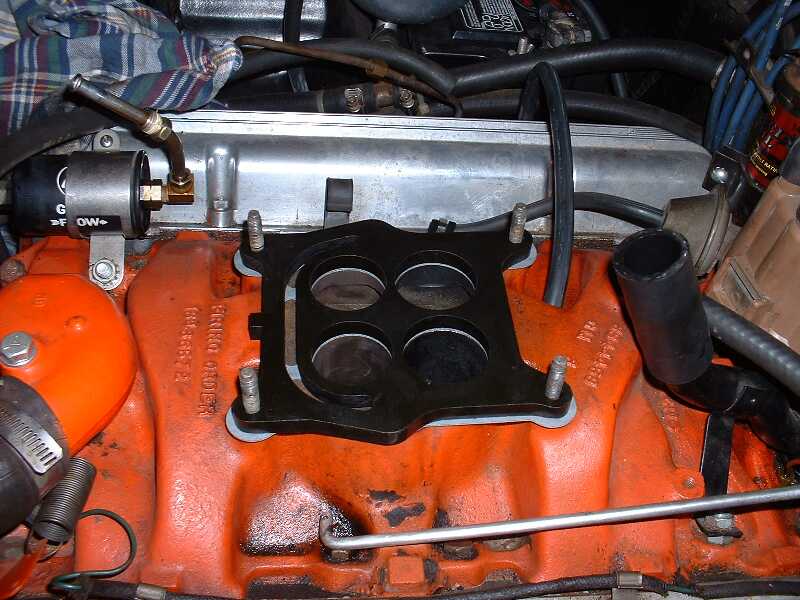

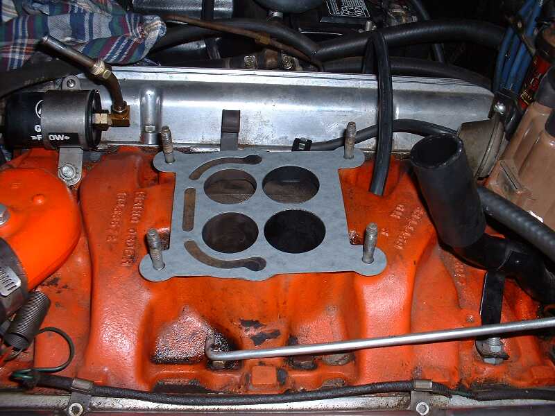

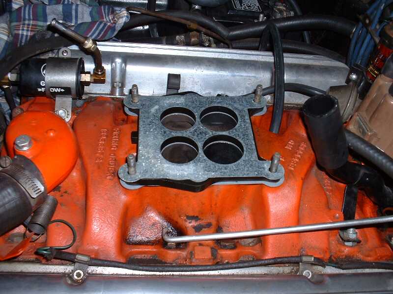

    gasket:
    spacer:
    baffle:
    please pardon the messy manifold
