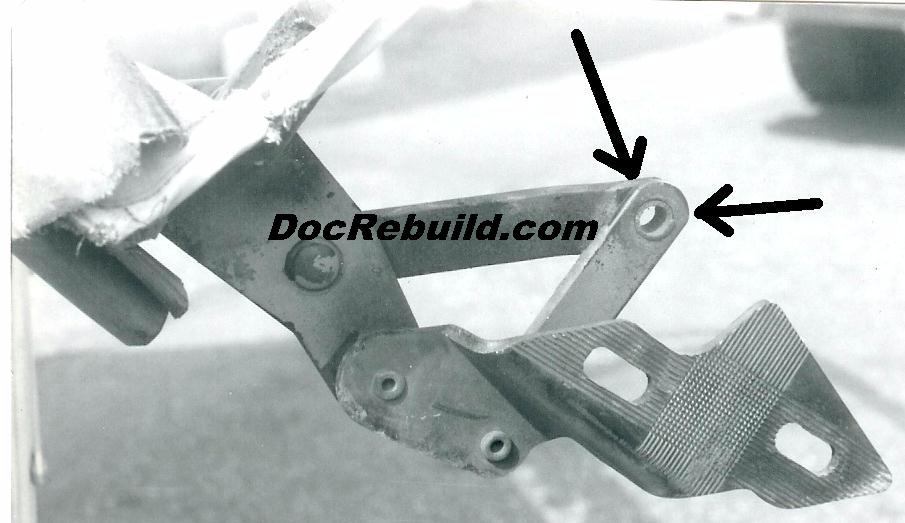

                    I have had a few power top cars and one tell tale piece of evidence are the 2 brackets shown in this picture. A clevis pin mounts them directly to the hydraulic cylinders for the bows. They are seldom removed from power top cars that have been gutted.
                    Geoffrey Coenen
