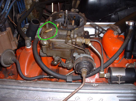

        Here's the fitting on the carb:

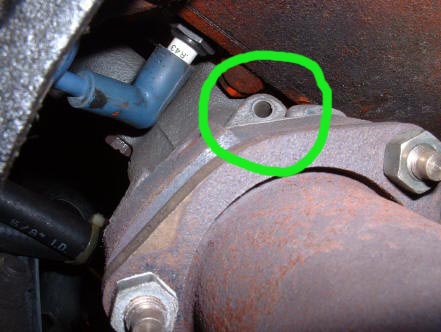

        Here's where the clean air tube attaches to the bottom of the passenger intake manifold:
        My AFB set-up lacked the clean air tube and the choke was all gummed up even though the tube inside the manifold was still intact.
        The metal tube thatattaches to the choke housing from the top of the manifold is called the "choke tube" and the one that fits into the bottom of the manifold is referred to as the "clean air tube".
