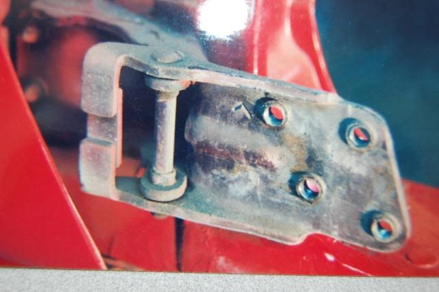

              Re: C3 Rear Deck Lid Hinge Color?
              Sheldon
              On my 68 and 69 the springs and hinges are black with body color over spray on them. There is actually very little over spray on the springs as they sit back quite a ways.
              Picture is from my 68: https://www.forums.ncrs.org/attachme...8&d=1258653123
