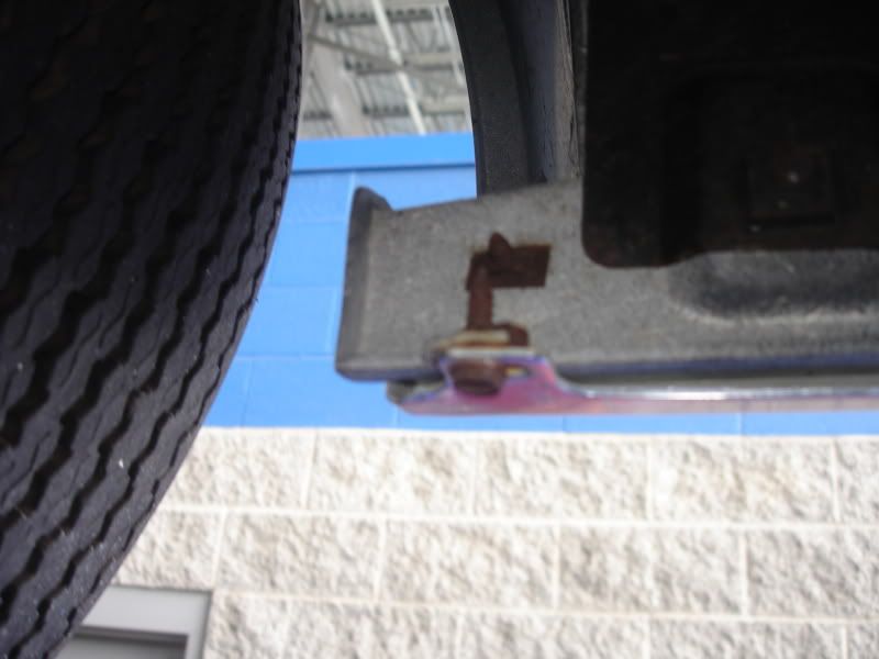

            Hank, My 72 does have two sets of holes, one front and one rearward about 5 or 6 inchs from the front ones.
            I can tell you that you maybe able to use the rear tabs and remount them forward, Just use a dremel tool with the cut off blade and then attach the tabs to the rocker first to get an idea of the area you'll need to attach,then maybe some fiberglass mat and use some Sems two part epoxy, which has some real good bonding abilility, the only down side to Sems its black in color.So use the fiberglass mat and expoxy on the rear side of fender only.

                Here's how it should look - these pictures are from a very low mile Bowtie car:
                Bloomington Gold 2011
                Corvette Magazine 9/11
                Bloomington Gold 2013
                Corvette Magazine 3/13
