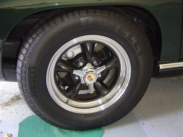

                        Thanks Joe. I can't find any on-line so I guess you are correct. Darn. Duke guided me to the Pirelli P-4000 for my former 1967 in an NCRS article from 20?? and it was just a superb tire. It's not that I go fast but the ruggedness of the sidewall and caps is a safety feature that appeals to me. Duke has spread this message so many times. If someone has a source for the RS-A 225-70 do let me know.

                          The tire article was spread over two issues of the The Corvette Restorer, and I think the year was 2003.
                          At the time there were three V-rated 225/70R-15 102V "police pursuit tires". The Firestone and General are gone, and now it looks like the last holdout from Goodyear may be history.
                          The 215/70ZR-15 Pirelli P4000 Super Touring will also work on all C3s, but the 225s fill out the wheelwells a little better.

                            The P4000 at 215/70 would probably be a little small for a C3. I have Goodyear 235/60s at the moment and with the 60s profile, they are marginal in filling the wheel wells. A 225/70 tire would be better but it really doesn't make sense to trade a 235/60 "S" tire for a 225/70 "S" tire. I'm really no further ahead in terms of safety. I get what it boils down to is a rapidly dwindling choice of tire for these old cars. I suspect that is why many are going to the 17" and 18" wheels with low profile tires. I'm not ready for that look.

                              Size 215/70R-15 is about the same OD and overall width as the F70-15, so some C3 owners prefer that size, but I've always recommended 225/70s since that was the radial size that GM used beginning in 1973, and they didn't cause any interference problems on earlier C3s.
                              Now, if there are no high speed rated 225/70s left, my choice for a C3 would be a high speed rated 215/70.
