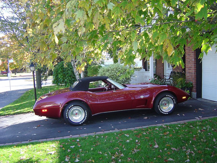

          That would be a very significant cost (my DD is an Impala) plus the terrible weather that can hit at this time of year. I don't need the hardtop that badly. It was to be a winter/basement restoration project that I very enjoy during the snowy months. My Haartz soft-top is like new and serves me well. The hardtop would be a nice addition but not essential.
