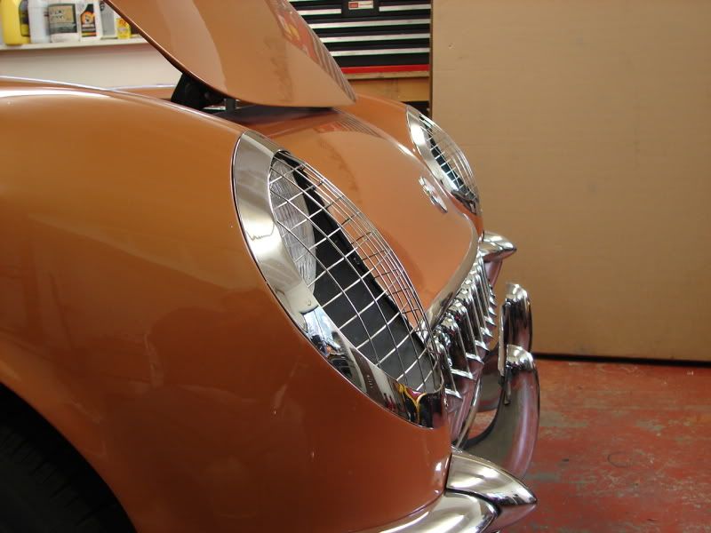

    How many see correct headlight stone guards on restored 53-55 Corvettes .
    Mine are new complete bucket units out of a box NOS and as you can see they follow the body line ( Bulging) all repro's I've seen are near flat looking. Rare I ever see correct ones on restored Corvettes. The repro's are made so that you cant get them to follow the body line (too short)
